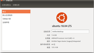

我的系统为ubuntu18.04,详细信息如下:

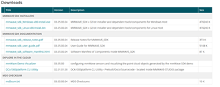

随后,我在TI官方网站中下载了uniflash_sl.7.0.0.3615.run文件和mmwave_sdk_03_05_00_04-Linux-x86-Install.bin文件:
并都增加可执行权限:
接着执行上述两个文件过程中均出现下述错误:无法执行二进制文件: 可执行文件格式错误

请参考下面的帖子。
UniFlash is not available for running on Arm based hosts. UniFlash is available for x86 machines running Windows/Linux/macOS.
https://e2e.ti.com/support/microcontrollers/arm-based-microcontrollers-group/arm-based-microcontrollers/f/arm-based-microcontrollers-forum/1006794/uniflash-unable-to-install-uniflash-on-jetson-nx
Mmwave SDK也不支持Arm based hosts。请看下面的帖子。
https://e2e.ti.com/support/sensors-group/sensors/f/sensors-forum/829631/iwr1642boost-controlling-the-board-using-raspberry-pi
请参考下面的帖子里的建议。
There is no plan to port the mmWave SDK to ARM Linux currently. However, the SDK is only required when building the firmware to run on the device. So, you can build and test the firmware using Windows or standard Ubuntu and then (after burning the firmware into the flash on the EVM) you can use a microcontroller or other external processor to communicate with the mmWave sensor over UART or another interface.
https://e2e.ti.com/support/sensors-group/sensors/f/sensors-forum/678213/linux-mmwave-sdk-installing-mmwave-sdk-on-armv7l-odroid-xu4
