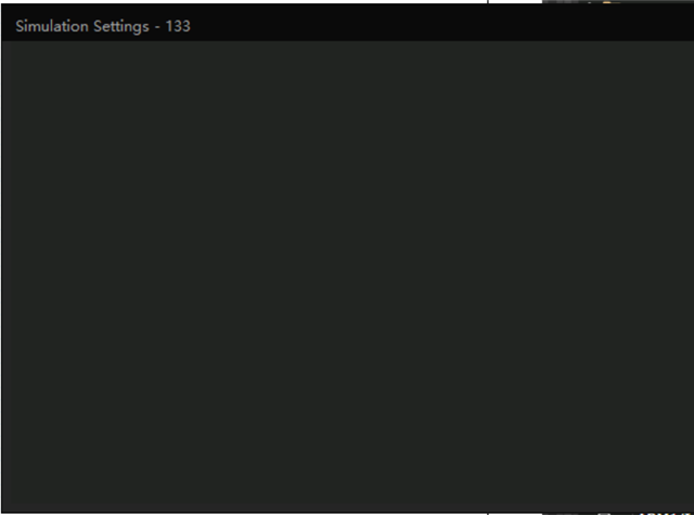

PSPICE-FOR-TI: 点击new simulation profile时出现黑色页面(如图),不显示设置内容
Part Number: PSPICE-FOR-TI
  • 您好,按照下面步骤试试能否解决您的问题:
    1. Close Pspice for TI.
    2. Open Task Manager and make sure that none of the below processes are running. If they are running, end them manually.
              MrKSrvr.exe
              PSpiceExplorerSrvr.exe
              Simmgr.exe
               SimSrvr.exe
              Pspice.exe
              Capture.exe
          3.Now open registry editor in the system  and delete CaptureTIPSpice_Install  folder from Computer\HKEY_CURRENT_USER\Software\OrCAD\CaptureTIPSpice_Install
           4. Now go to  %cds_home%\cdssetup\OrCAD_PSpiceTIPSpice_Install\17.4.0 location and rename the  PSpice.ini to Pspice_old.ini
          5. Now go to  %cds_home%\cdssetup\OrCAD_CaptureTIPSpice_Install\17.4.0 location and rename Capture.ini to Capture_old.ini
        6.  Now invoke the tool and check.
