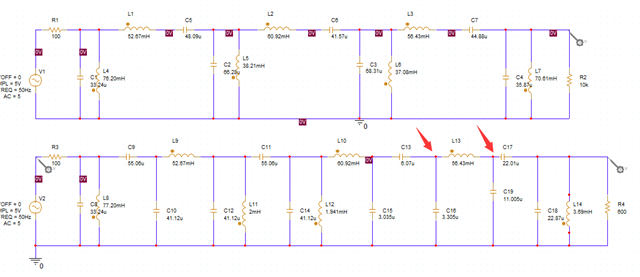

PSPICEFORTI :LC 带通电路为何会报ERROR(ORPSIM-15142): Node N16481 is floating
 这俩个地方怎么回事,总是报错ERROR(ORPSIM-15142): Node N16481 is floating
