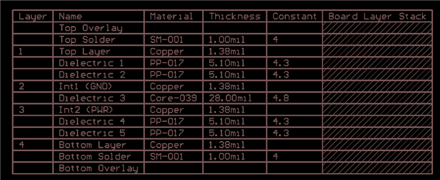

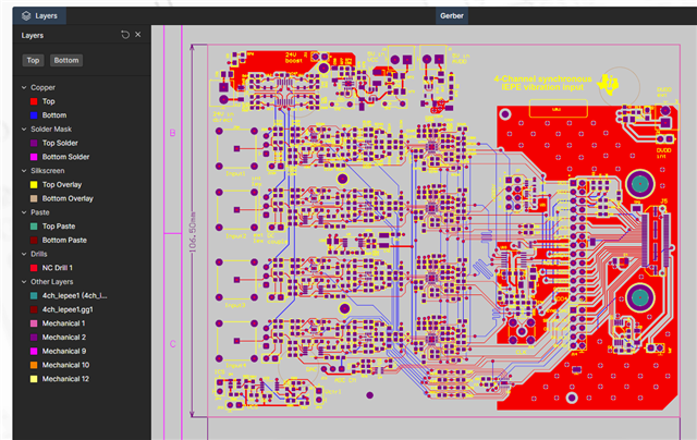

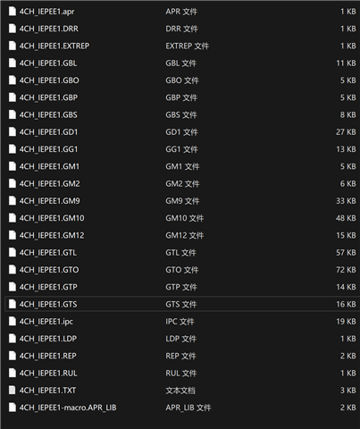

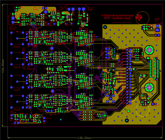

Dear Sir,
I am looking at the Gerber file for this PCB and I noticed in the Gerbe it mentioned there are 4 layers (with 2 inner layers), but cannot find it in the design files.
Would you mind advice any solutions?
