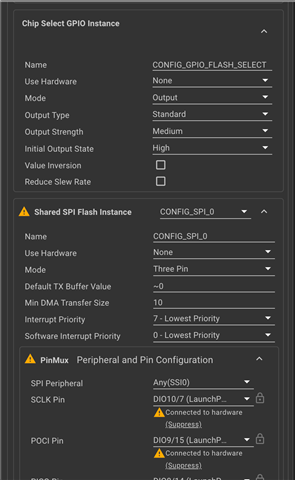

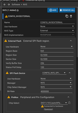

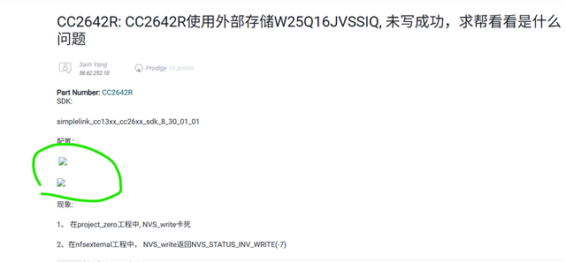

CC2642R: CC2642R使用外部存储W25Q16JVSSIQ, 未写成功,求帮看看是什么问题
Part Number: CC2642R
SDK:
simplelink_cc13xx_cc26xx_sdk_8_30_01_01
配置:
现象:

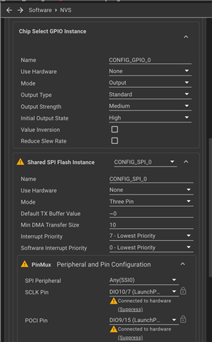

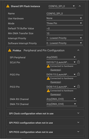

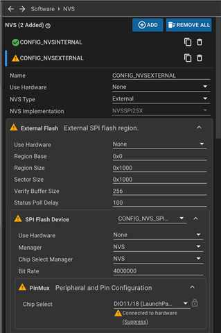

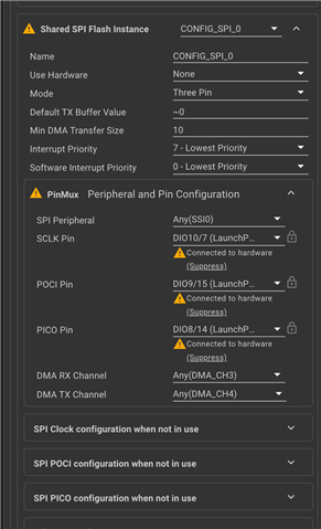

1、 在project_zero工程中, NVS_write卡死
2、在nfsexternal工程中, NVS_write返回NVS_STATUS_INV_WRITE(-7)

输出
Sector Size: 0x1000
Region Size: 0x1000
NVS_erase, rc = 0
Writing signature to SPI flash...
Write, rc = -7
read 0:
Reset the device.
