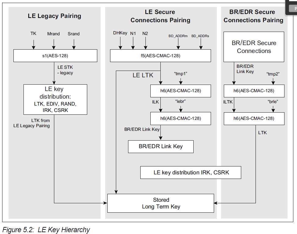

如题。legacy pairing的LTK 如何生成?

你好,
LTK的生成是协议栈lib做好了,如果你希望详细了解,下面的资料供你参考,你也可以详细研读蓝牙SPEC。

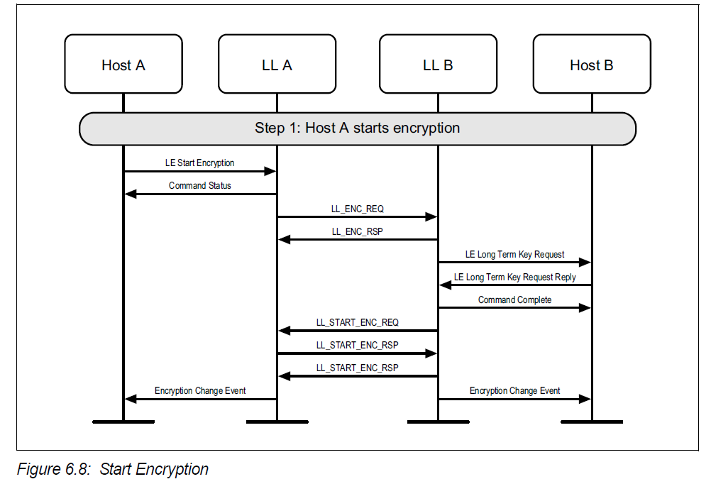

建立连接的过程如下:
LTK generation process show as below for your information.
The security key hierarchy for LE is shown in Figure 5.2. The key hierarchy is
different depending on whether a physical link is using LE Secure Connections
or LE legacy pairing procedures and algorithms.
