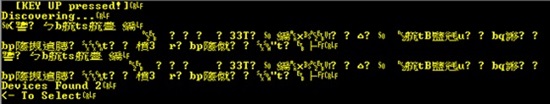

    接着,我把RSSI印出
        case GAP_DEVICE_INFO_EVENT:
            // if filtering device discovery results based on service UUID
            if ( DEFAULT_DEV_DISC_BY_SVC_UUID == FALSE )
                SimpleBLECentral_addDeviceInfo ((uint8*)(- pEvent->deviceInfo.rssi), pEvent->deviceInfo.addrType );
          break;
    static void SimpleBLECentral_addDeviceInfo(uint8_t *pAddr, uint8_t addrType)
    uint8_t i;
    // If result count not at max
    if (scanRes < DEFAULT_MAX_SCAN_RES)
    // Check if device is already in scan results
    for (i = 0; i < scanRes; i++)
    if (memcmp(pAddr, devList[i].addr , B_ADDR_LEN) == 0)
    return;
        SerialPrintString((uint8*) (pAddr));
        SerialPrintString("\r\n");
    // Add addr to scan result list
    memcpy(devList[scanRes].addr, pAddr, B_ADDR_LEN);
    devList[scanRes].addrType = addrType;
    // Increment scan result count
    scanRes++;
    结果如下图
    请问我在印出RSSI出了什么问题呢?
