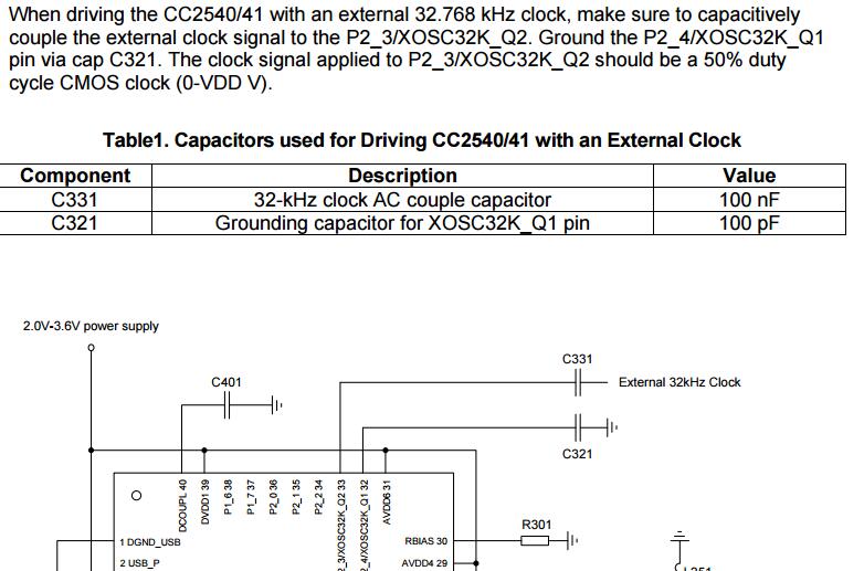

I want to use power mode of CC254x, and need to add an external 32kHz clock
refer to AN119, there is an application circuit below
And I am not very sure about where is the other pin of the 32kHz Clock?
Do you have a Sch has more details?
