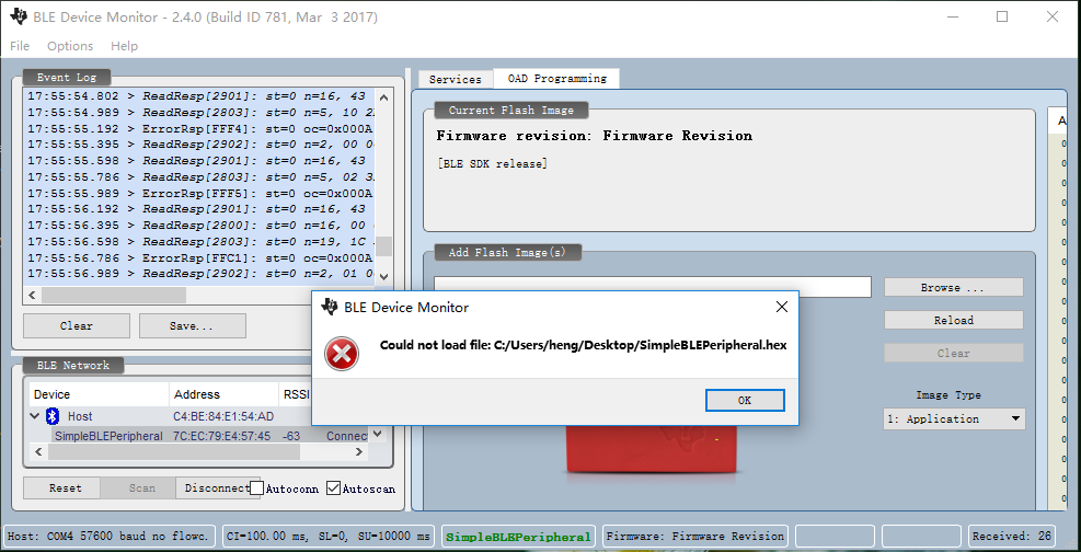

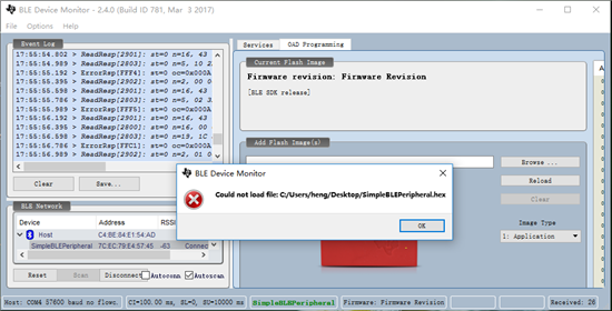

用BLE Device Monitor进行OAD时出错
用BLE Device Monitor进行OAD时,出现如下问题:
无法添加要升级的固件
  • 请按照本手册进行操作: http://processors.wiki.ti.com/index.php/BLE_Device_Monitor_User_Guide
    并确保“Wait 5-10 seconds after connect before you go into the OAD item on the file menu”
