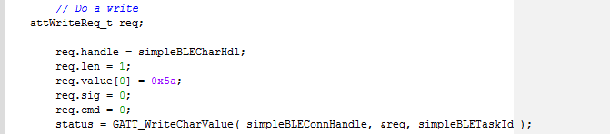

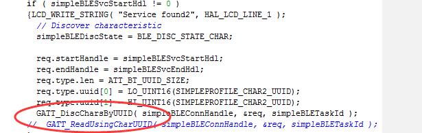

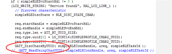

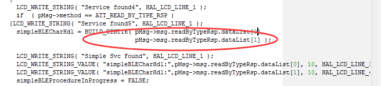

2441主机通过GATT_DiscCharsByUUID()获取到特性值的handl后,无法对该特性值写数据,返回的状态是error 3,请问是什么原因导致的呢
  • 读写主要使用GATT_WriteCharValue()和GATT_ReadCharValue().可参考协议栈中例程
        // If procedure complete
        if ( ( pMsg->method == ATT_FIND_BY_TYPE_VALUE_RSP  &&
               pMsg->hdr.status == bleProcedureComplete ) ||
             ( pMsg->method == ATT_ERROR_RSP ) )
          if ( simpleBLESvcStartHdl != 0 )
            // Discover characteristic
            simpleBLEDiscState = BLE_DISC_STATE_CHAR;
            req.startHandle = simpleBLESvcStartHdl;
            req.endHandle = simpleBLESvcEndHdl;
            req.type.len = ATT_BT_UUID_SIZE;
            req.type.uuid[0] = LO_UINT16(SIMPLEPROFILE_CHAR1_UUID);
            req.type.uuid[1] = HI_UINT16(SIMPLEPROFILE_CHAR1_UUID);
            GATT_ReadUsingCharUUID( simpleBLEConnHandle, &req, simpleBLETaskId );
      else if ( simpleBLEDiscState == BLE_DISC_STATE_CHAR )
        // Characteristic found, store handle
        if ( pMsg->method == ATT_READ_BY_TYPE_RSP &&
             pMsg->msg.readByTypeRsp.numPairs > 0 )
          simpleBLECharHdl = BUILD_UINT16( pMsg->msg.readByTypeRsp.dataList[0],
                                           pMsg->msg.readByTypeRsp.dataList[1] );
          LCD_WRITE_STRING( "Simple Svc Found", HAL_LCD_LINE_1 );
          simpleBLEProcedureInProgress = FALSE;
        simpleBLEDiscState = BLE_DISC_STATE_IDLE;
