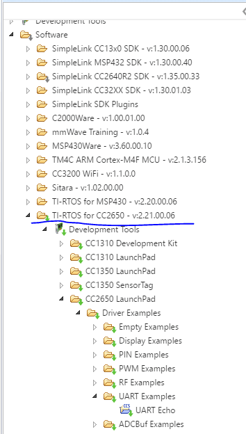

CC2650 CC2640的例程是通用的,相同的封装也是引脚兼容的
The multi-standard CC2650 wireless MCU supports BLE as well as other wireless protocols, such as 802.15.4. The CC2640 supports Bluetooth Low Energy only. All code generated from the BLE-Stack 2.0 SDK is binary compatible with both the CC2650 & CC2640. Additionally, IDE project configuration settings in the BLE-Stack v2.0 SDK for CC2650 & CC2640 are cross-compatible; however, it is strongly recommended to not change the CPU settings in the IDE. Although the CC2650 has the HW & ROM capability to support additional wireless protocols, a given SW build can only support one wireless protocol.
