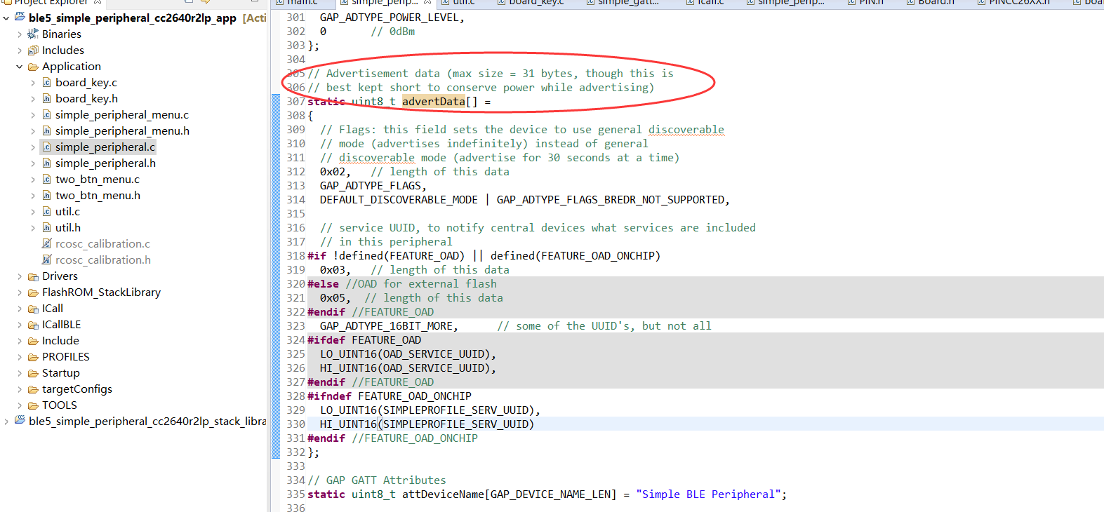

想问一下,为什么注释还是写着广播包最大是31Byte的数据,BLE5不应该是最大255个Byte吗?
Hi All
It is true that the Bluetooth 5 specification enables the Advertisement Extension (AE) feature with payload sizes up to 255 bytes; however, this feature is not supported in the CC2640R2 SDK v1.35. We intend to offer AE in a future CC2640R2 SDK release.
