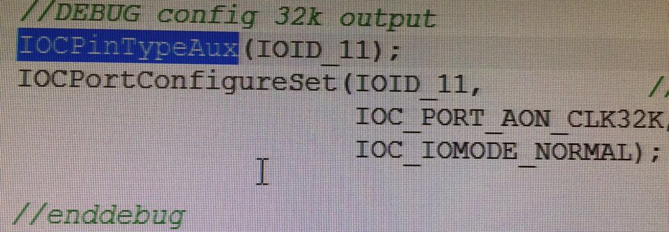

CC2640R2F 如何使用GPIO 输出clock 32k?配置管脚如下,
但是测量此管脚IOID_11,始终是低电平。求点解?
  • 可以参照:
    IOCPortConfigureSet(IOIDn, IOC_PORT_AON_CLK32K, IOC_STD_OUTPUT);
    AONIOC32kHzOutputEnable();
    http://dev.ti.com/tirex/content/simplelink_cc2640r2_sdk_1_00_00_22/docs/driverlib_cc13xx_cc26xx/cc13x0/driverlib/group__aonioc__api.html
