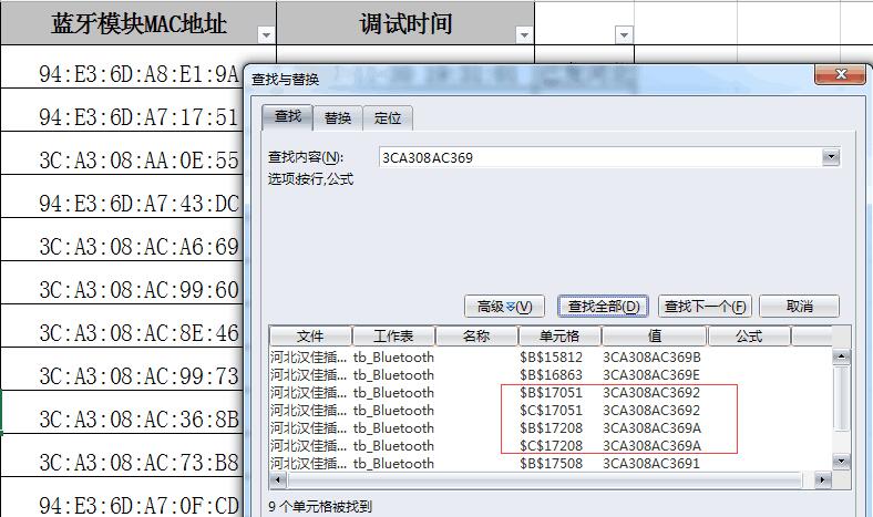

如图:
以上是我们客户记录的地址列表, 客户反映重复的“数量太大”。
我们这边出货这么多也是第一次听到这种情况, 就希望你们 TI这边能够帮忙确定一下是否真的存在“地址重复”的情况

是的, 就是芯片本身的地址。(至少我们出厂时是没做更改, 询问客户也说没改过)
The Information Page is a 2-KB read-only region that stores various device information. Among other
things, it contains for IEEE 802.15.4 or Bluetooth low energy compliant devices a unique IEEE address
from the TI range of addresses. For CC253x, this is a 64-bit IEEE address stored with least-significant
byte first at XDATA address 0x780C. For CC2540/41, this is a 48-bit IEEE address stored with
least-significant byte first at XDATA address 0x780E
你的是这个地址吗,用SmartRF Flash Programmer读一下试试。
