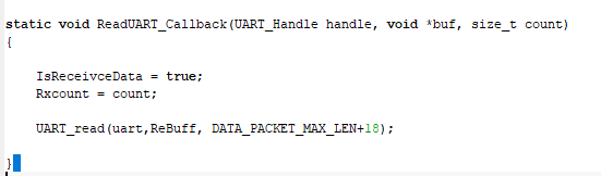

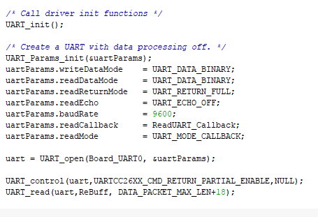

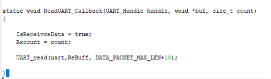

CC2640R2F SDK10.0 用uart_read();异步去读串口数据的函数,功耗就会一直飙升到2.5毫安!!求助
Other Parts Discussed in Thread: CC2640
还有什么办法可以降低功耗,去进行串口数据收发吗?????

  • 照下面的link做. 这个驱动考虑了低功耗.通过外部IO口控制穿裤偶是否进入低功耗.
    static void NPITL_setPM(void)
    if( npiPMSetConstraint )
    return;
    // set constraints for Standby and idle mode
    Power_setConstraint(PowerCC26XX_SB_DISALLOW);
    Power_setConstraint(PowerCC26XX_IDLE_PD_DISALLOW);
    npiPMSetConstraint = TRUE;
    #endif // NPI_FLOW_CTRL = 1
    #if (NPI_FLOW_CTRL == 1)
    //! \brief This routine is used to release constraints on power manager
    //! \return void
    static void NPITL_relPM(void)
    if ( ! npiPMSetConstraint )
    return;
    // release constraints for Standby and idle mode
    Power_releaseConstraint(PowerCC26XX_SB_DISALLOW);
    Power_releaseConstraint(PowerCC26XX_IDLE_PD_DISALLOW);
    npiPMSetConstraint = FALSE;
