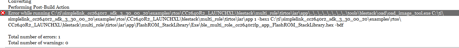

CC2640R2F在空工程添加OAD报错
我要在一个空工程添加OAD功能,参考的是
dev.ti.com/.../node
这个帖子,例程也是用这里面说的multi_role的工程去添加OAD。当我输入完APP工程的Build Action->Post-build command line:cmd /C "$TOOLS_BLE_DIR$\oad\oad_image_tool.exe iar $PROJ_DIR$ 1 -hex1 $EXE_DIR$\$TARGET_BNAME$.hex -bdf $PROJ_DIR$\..\config\iar_boundary.xcl -hex2 $PROJ_DIR$\..\stack\FlashROM_Library\Exe\ble_multi_role_cc2640r2lp_stack_FlashROM_Library.hex -k "$TOOLS_BLE_DIR$\oad\private.pem" -o $EXE_DIR$\$TARGET_BNAME$_oad"后编译会报错运行错误望解答。
