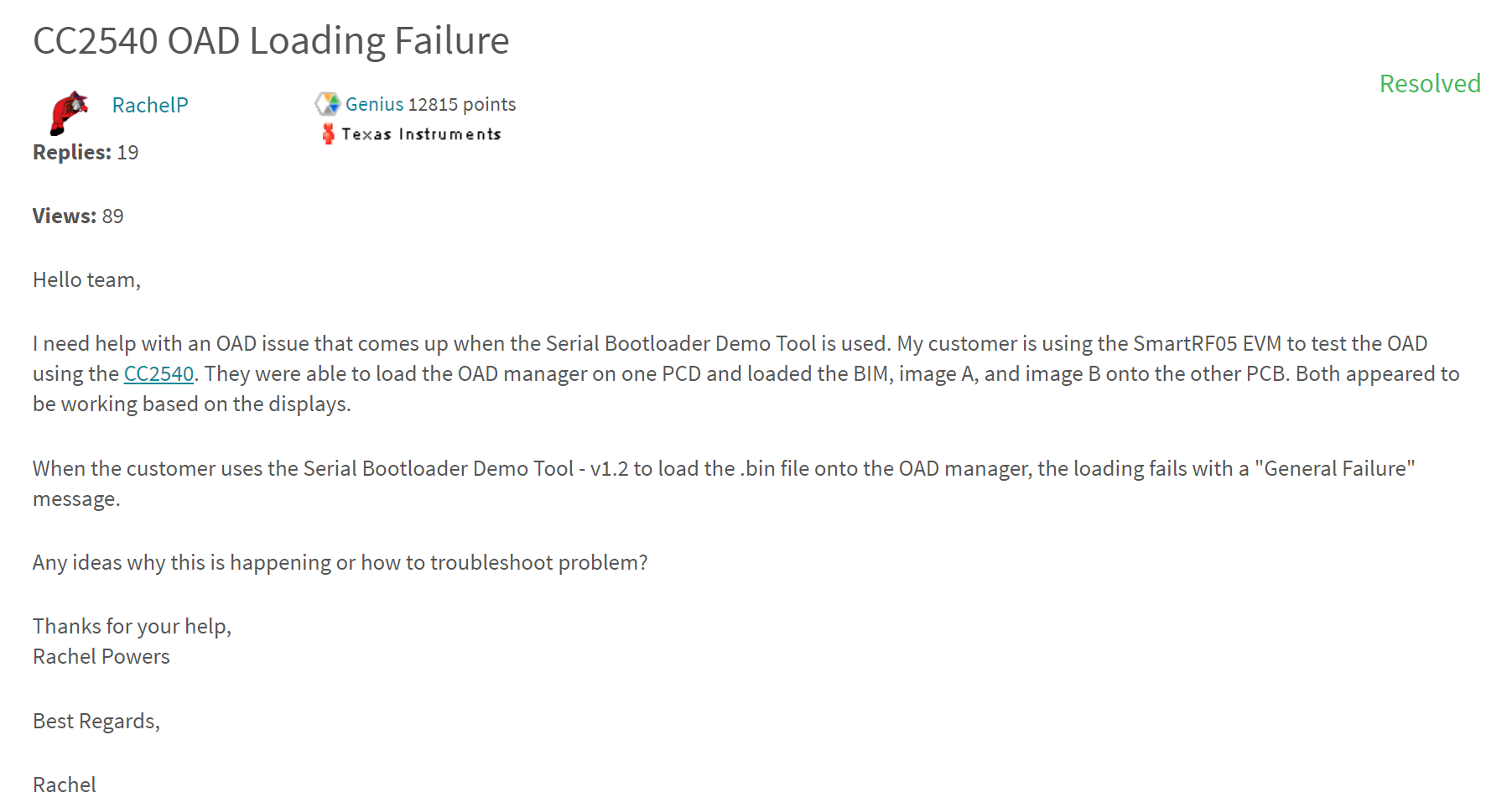

那你按照步骤排查下吧,生成OAD的一般步骤是:
Flash OAD target with BIM
Flash OAD target with ImgA and ImgB hex files the customer provided (making sure to select the append option in flash programmer so as to not overwrite the BIM)
Flash OADManager to OAD downloader
Use above project file to generate ImgB for OAD
plug .bin file into SBT
On OAD downloader (OAD Manager device) select the correct peripheral based on address, and click the center button to initialize OAD
Warning[w28]: Parts of segment <XDATA_ROM_C> 1 are initialized (as in module
?FILLER_BYTES), parts not (as in module simpleBLECentral)
出现这个warning,生成的bin就下载不了???怎么解决一下,谢谢
