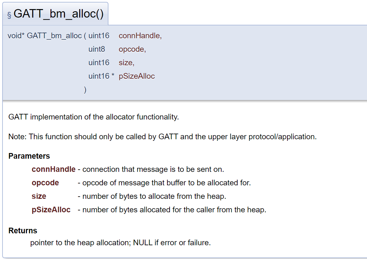

我咨询下关于 GATT_bm_alloc 和 GATT_bm_free 这两个函数的用法
1.  例程中经常有这样的用法
req.pValue = GATT_bm_alloc(connHandle, ATT_WRITE_REQ, len, NULL);
// If successfully allocated
if (req.pValue != NULL)
// Fill up request
connIndex = multi_role_mapConnHandleToIndex(connHandle);
req.handle = discInfo[connIndex].charWriteHdl;
req.len = len;
memcpy(req.pValue, pData,req.len);
req.sig = 0;
req.cmd = 0;
// Send GATT write to controller
status = GATT_WriteCharValue(connHandle, &req, selfEntity);
// If not sucessfully sent
if ( status != SUCCESS )
// Free write request as the controller will not
GATT_bm_free((gattMsg_t *)&req, ATT_WRITE_REQ);
        GATT_bm_alloc 返回的地址  和   GATT_bm_free 释放的地址不是同一个,是用GATT_bm_free 的第二个参数进行识别,然后真正释放的是 req.pValue 的地址吗?
2. 如果GATT_bm_alloc 调用后,if (req.pValue == NULL),  是否还需要调用GATT_bm_free  释放内存?
