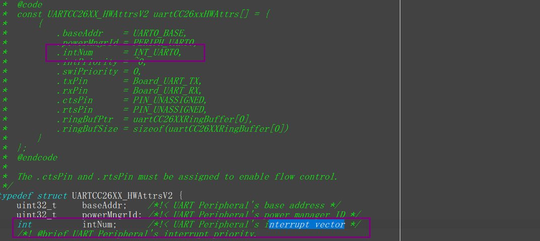

关于协议栈1.40.00.45中断向量池里面串口的标号在哪里找?
技术大佬,麻烦问一下,在配置串口时候,需要指定中断向量表里面串口的标号,这个标号在哪里找到?
如图中这个配置串口结构体里面的成员intnum的值。如何找到是多少?
  • 这个是定义在hw_ints.h内的
    附上文件源码

    #ifndef __HW_INTS_H__
    #define __HW_INTS_H__
    // The following are defines for the interrupt assignments.
    #define INT_NMI_FAULT                    2 // NMI Fault
    #define INT_HARD_FAULT                   3 // Hard Fault
    #define INT_MEMMANAGE_FAULT              4 // Memory Management (MemManage)
                                               // Fault
    #define INT_BUS_FAULT                    5 // Bus Fault
    #define INT_USAGE_FAULT                  6 // Usage Fault
    #define INT_SVCALL                      11 // Supervisor Call (SVCall)
    #define INT_DEBUG                       12 // Debug Monitor
    #define INT_PENDSV                      14 // Pending Service Call (PendSV)
    #define INT_SYSTICK                     15 // SysTick Interrupt from the
                                               // System Timer in NVIC.
    #define INT_AON_GPIO_EDGE               16 // Edge detect event from IOC
    #define INT_I2C_IRQ                     17 // Interrupt event from I2C
    #define INT_RFC_CPE_1                   18 // Combined Interrupt for CPE
                                               // Generated events
    #define INT_AON_RTC_COMB                20 // Event from AON_RTC
    #define INT_UART0_COMB                  21 // UART0 combined interrupt
