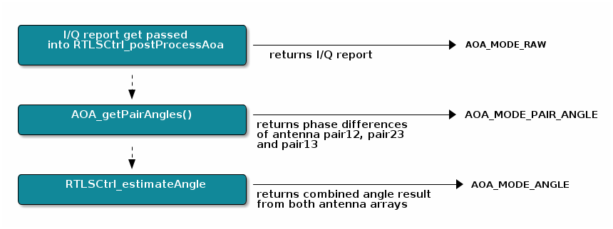

我们使用MASTER+PASSIVE(BOOSTXL-AOA)+SLAVER进行测试,采用RTLS_CMD_AOA_RESULT_ANGLE模式,可以获取AOA角度,但是AOA输出的角度,与我们实际摆放角度基本没什么关系,输出结果都差不多,并且角度变化很大,这个问题如何排查?是不是RTLS_CMD_AOA_SET_PARAMS 配置的参数有关,目前是参照PATHON配置的4,4,20
| TIME | ANGLE | RSSI | ANT | CHANNEL |
| 17:00:37 | 8 | -85 | 1 | 23 |
| 17:00:37 | 0 | -85 | 2 | 7 |
| 17:00:37 | -8 | -84 | 2 | 21 |
| 17:00:38 | -18 | -86 | 2 | 35 |
| 17:00:38 | -26 | -86 | 2 | 12 |
| 17:00:38 | -36 | -84 | 2 | 26 |
| 17:00:38 | -36 | -86 | 1 | 33 |
| 17:00:38 | -36 | -84 | 2 | 17 |
| 17:00:39 | -19 | -85 | 1 | 24 |
| 17:00:39 | -18 | -85 | 2 | 8 |
| 17:00:39 | -1 | -84 | 1 | 15 |
| 17:00:39 | 16 | -85 | 1 | 29 |
| 17:00:39 | -1 | -84 | 2 | 13 |
| 17:00:40 | 16 | -84 | 1 | 20 |
| 17:00:40 | 16 | -86 | 1 | 34 |
| 17:00:40 | 16 | -84 | 2 | 18 |
| 17:00:40 | 16 | -85 | 1 | 25 |
| 17:00:40 | -1 | -86 | 2 | 9 |
| 17:00:41 | 16 | -84 | 1 | 16 |
| 17:00:41 | -1 | -86 | 2 | 0 |
| 17:00:41 | -18 | -84 | 2 | 14 |
| 17:00:41 | -18 | -84 | 2 | 28 |
| 17:00:41 | -18 | -86 | 1 | 35 |
| 17:00:42 | -18 | -84 | 2 | 19 |
| 17:00:42 | -18 | -84 | 1 | 26 |
| 17:00:42 | -19 | -84 | 2 | 17 |
| 17:00:42 | -1 | -84 | 1 | 24 |
| 17:00:43 | -1 | -86 | 2 | 8 |
| 17:00:43 | -18 | -84 | 2 | 22 |
