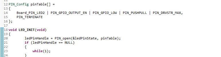

通过pin_open是否可以点亮LED灯?
给你一段代码看看。
void led_init()
PIN_State ledPinState;
PIN_Config ledPinTable[] = {
Board_PIN_LED0 | PIN_GPIO_OUTPUT_EN | PIN_GPIO_LOW | PIN_PUSHPULL | PIN_DRVSTR_MAX,
PIN_TERMINATE
ledPinHandle = PIN_open(&ledPinState, ledPinTable);
PIN_setOutputValue(ledPinHandle, Board_PIN_LED0, CC1310_LAUNCHXL_GPIO_LED_ON);
void led_on()
PIN_setOutputValue(ledPinHandle, Board_PIN_LED0, Board_LED_ON);
void led_off()
PIN_setOutputValue(ledPinHandle, Board_PIN_LED0, Board_LED_OFF);
void led_reverse()
PIN_setOutputValue(ledPinHandle, Board_PIN_LED0,!PIN_getOutputValue(Board_PIN_LED0));
void led_close()
PIN_close(ledPinHandle);
