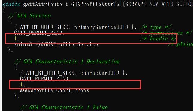

技术你好,我使用从机例程,CC2640R2F,版本是cc2640r2_sdk_1_40_00_45,iar软件,在从机例程添加自定义服务。

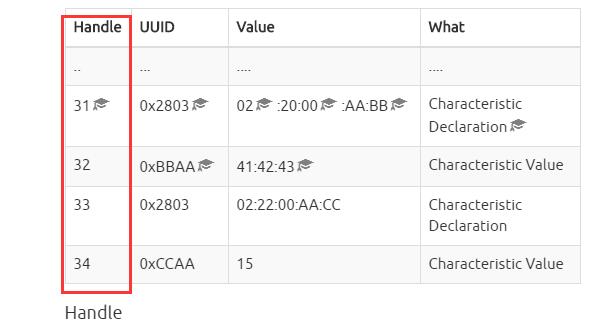

不是一个东西吗?

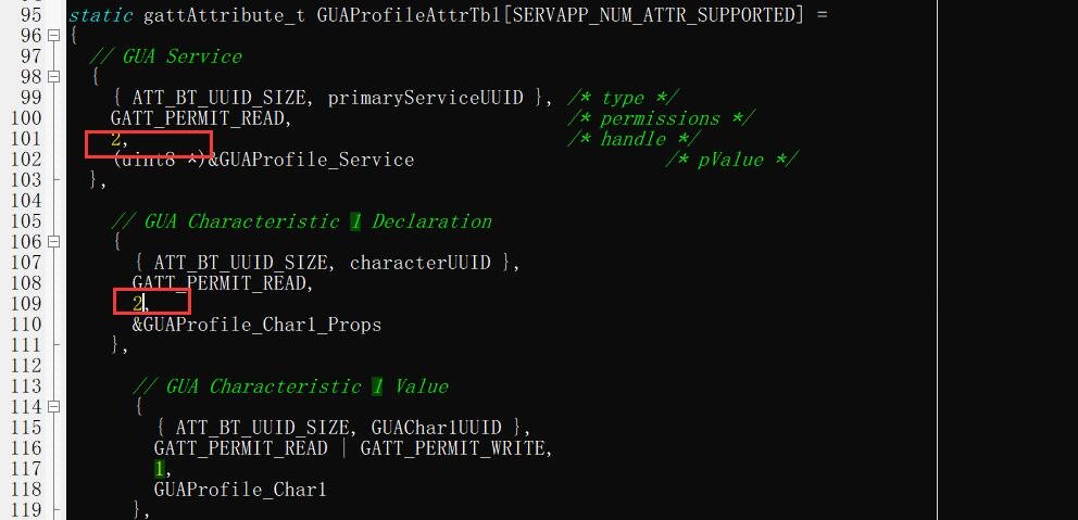

这个handle不是自己定义的,内部自动分配的,看下面代码:
typedef struct attAttribute_t
gattAttrType_t type; //!< Attribute type (2 or 16 octet UUIDs)
uint8 permissions; //!< Attribute permissions
uint16 handle; //!< Attribute handle - assigned internally by attribute server
uint8* const pValue; //!< Attribute value - encoding of the octet array is defined in
//!< the applicable profile. The maximum length of an attribute
//!< value shall be 512 octets.
} gattAttribute_t;
