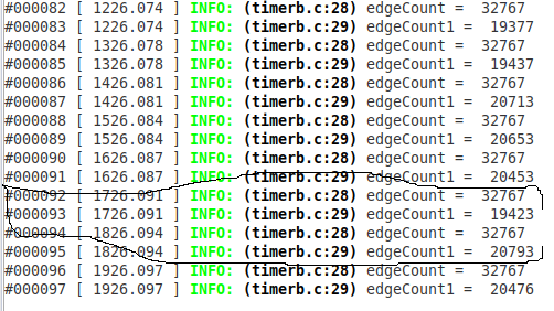

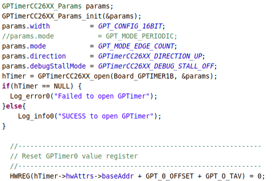

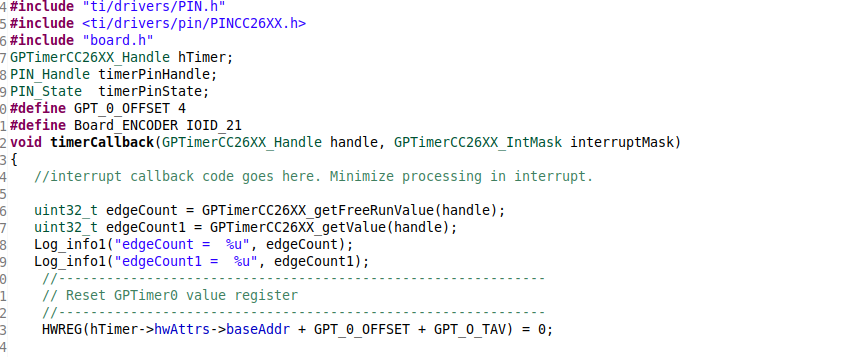

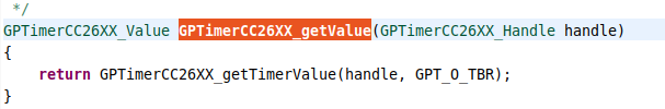

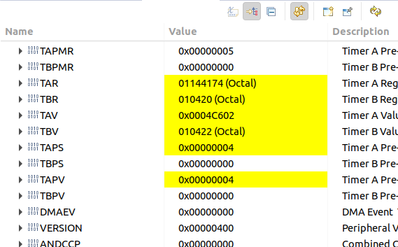

为啥我设置成GPTimer读取的数据会是478479,我读取的是TBR寄存器,而读取TBV寄存器的值为啥总是32767,我想知道我设置的match Value == 10000,是否生效。
Timer B Register
This register shows the current value of the Timer B counter in all cases except for Input Edge Count and Time modes. In the Input Edge Count mode, this register contains the number of edges that have occurred. In the Input Edge Time mode, this register contains the time at which the last edge event took place.
