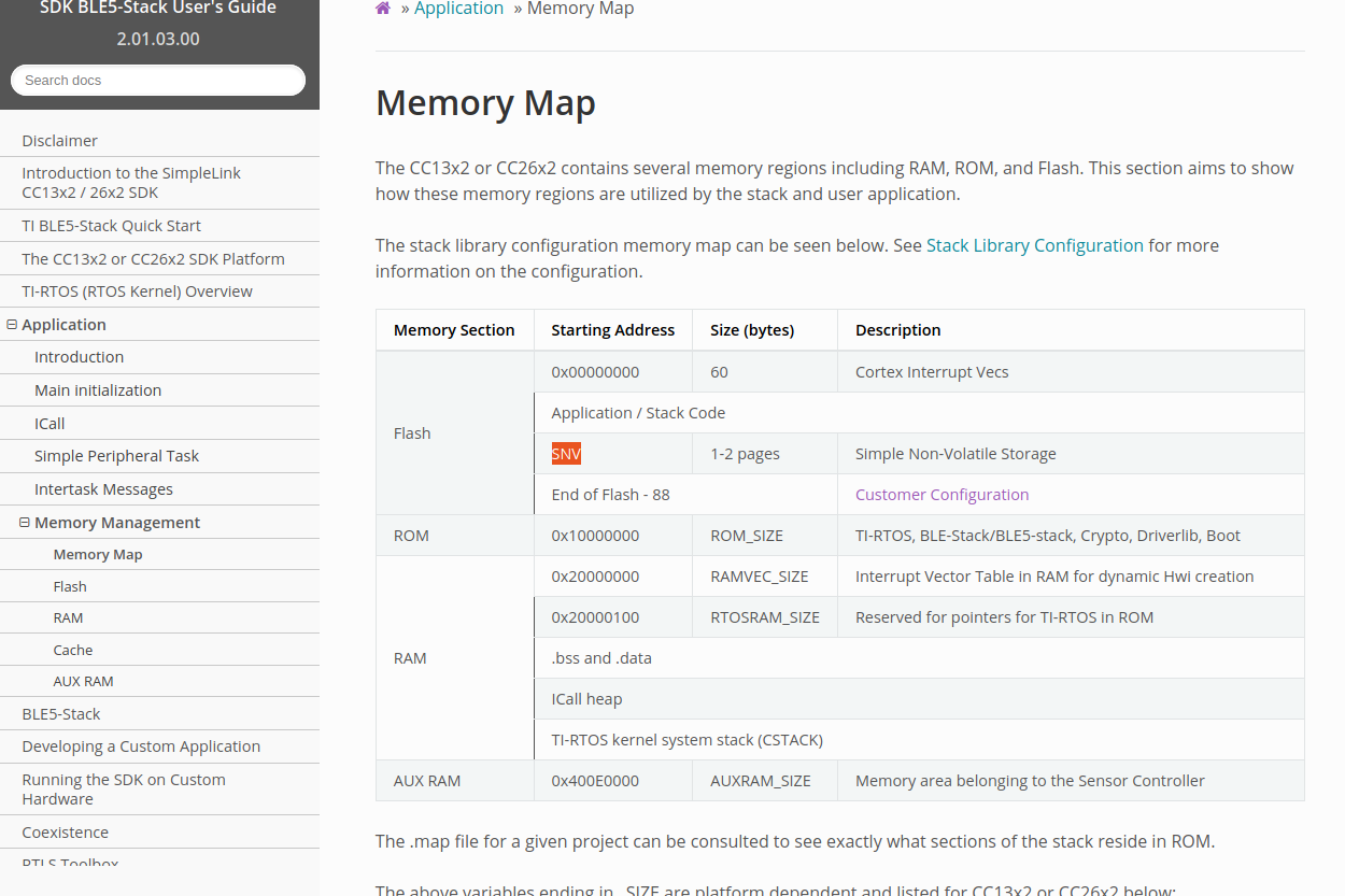

  •  我想知道CC2642R1F SNV的地址范围包括起始地址,谢谢
  • 默认地址是0x48000,SNV区大小:0x4000,地址可以灵活放置
    Placing OSAL SNV
    This section details how the SNV flash sector is placed in memory. OSAL SNV is implemented as a constant array defined in the board file as flashBuf[REGIONSIZE]. The location of this buffer is set by NVS_REGIONS_BASE in the *_LAUNCHXL.c board file. Placement of this structure is flexible and configurable by the user so long as the intended use guidelines are followed.
    This structure is accessed via the NVINTF through NVSCC26XX_* APIs.
