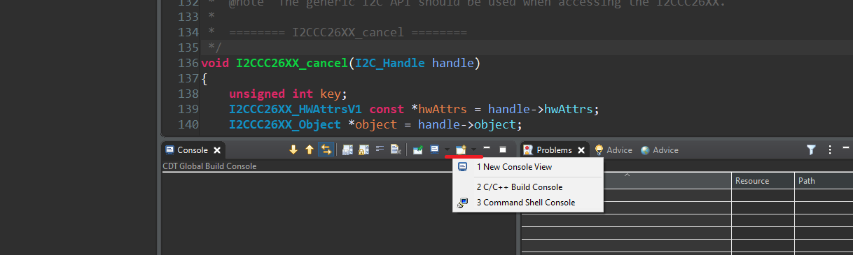

平台CC2650, CCS是8.1.
驱动中有Log_print2打印函数,仿真时如何能显示到console口或串口上
平台:CC2650
SDK: tirtos_cc13xx_cc26xx_2_21_00_06
xdc:xdctools_3_32_00_06_core
参考:
http://rtsc.eclipseprojects.io/docs-tip/Using_xdc.runtime_Logging/Example_1
Bios_User_Guide.pdf的9.5.1.1
在*.cfg文件中修改 Text.isLoaded = true;
在*.cfg文件中添加
var Defaults = xdc.useModule('xdc.runtime.Defaults');
var Log = xdc.useModule("xdc.runtime.Log");
var Diags = xdc.useModule("xdc.runtime.Diags");
/* enable runtime control of "info" events for non-modules */
var Main = xdc.useModule("xdc.runtime.Main");
Main.common$.diags_INFO = Diags.RUNTIME_ON;
Defaults.common$.diags_USER1 = Diags.ALWAYS_ON;
/* use the LoggerSys ILogger service provider */
var Logger = xdc.useModule("xdc.runtime.LoggerSys");
/* create and bind a logger for all non-module code */
Main.common$.logger = Logger.create();
