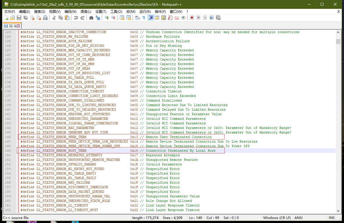

cc1350p2 音频传输会自动终止
Other Parts Discussed in Thread: CC1352P

#000011 [ 6.706 ] INFO: (ble_audio.c:1003) Audio Stream Started
#000012 [ 8.519 ] WARNING: (ble_audio.c:427) Connection Event Error: Missed event
#000013 [ 12.778 ] WARNING: (ble_audio.c:427) Connection Event Error: Missed event
#000014 [ 12.787 ] WARNING: (ble_audio.c:427) Connection Event Error: Missed event
#000015 [ 12.797 ] WARNING: (ble_audio.c:427) Connection Event Error: Missed event
#000016 [ 12.797 ] WARNING: (ble_audio.c:432) Missed packets > buffer length, stopping stream and connection
#000017 [ 12.820 ] INFO: (ble_audio.c:1019) Stream stopped, disconnecting
#000018 [ 12.821 ] WARNING: (ble_audio.c:427) Connection Event Error: Missed event
#000019 [ 12.821 ] WARNING: (ble_audio.c:427) Connection Event Error: Missed event
#000020 [ 12.821 ] ERROR: (central_bidirectional_audio.c:874) Unknown Cmd Status: 0x0406::0x00
#000021 [ 12.827 ] WARNING: (ble_audio.c:427) Connection Event Error: Missed event
#000022 [ 12.837 ] WARNING: (ble_audio.c:427) Connection Event Error: Missed event
#000023 [ 12.837 ] WARNING: (ble_audio.c:432) Missed packets > buffer length, stopping stream and connection

专家您好:
      cc1350p2 蓝牙传输会自动终止,我们使用的sdk为《simplelink_audio_plugin_3_30_00_06》、《simplelink_cc13x2_26x2_sdk_3_30_00_03》,工程路径C:\ti\simplelink_audio_plugin_3_30_00_06\examples\rtos\CC1352P_2_LAUNCHXL\ble5stack\central_bidirectional_audio、peripheral_bidirectional_audio,附件是log打印。
        log提示是没有event。现象是按说明操作后,能够出声音,但很短时间后,log会打印很多warning,声音也随之终止。如果在ble_audio.c文件中的393行,即while (pMsg = Util_dequeueMsg(appMsgQueueHandle))行打断点,可以看到,event的值不包含BLEAUDIO_DATA_READY_EVT、BLEAUDIO_DATA_NEEDED_EVT。
麻烦专家看看,是否是在什么地方配置不对。
