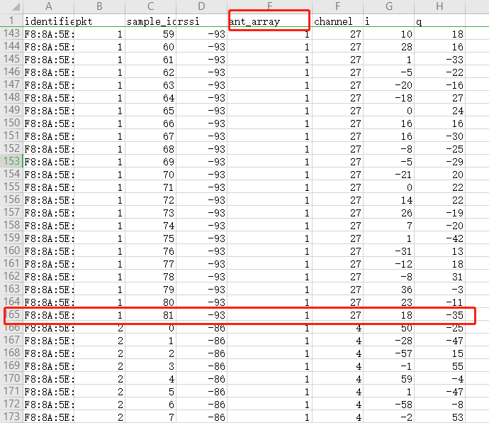

请问用CC26X2的SDK(4_30版本)pytho采集的IQ CSV格式的IQ数据,现在只能只能看到是哪一组天线(ant_array),有没有什么办法实现区分具体是哪一组的哪根天线。
另外python在以下配置时参数时,每一组PKT只有82个数据,这个是怎么来?既不是天线数3的倍数也不是16的倍数。和之前CC2640中的有较大区别。

  • 1、目前SDK里一次只能使用一个antenna array,无法同时使用。至于具体的天线,是通过GPIO控制的,你可以尝试从这里入手,找找方法区分
    2、packet length跟采样率和内存有关:
    For rtls_passive, the I/Q sampling rate is currently not configurable and it is 4 MHz. Each I/Q pair occupies 32 bits space in radio RAM and the radio RAM can store up to 512 samples (i.e. 2048 bytes - 2 kB). This limitation is only due to the micro-stack which limits the amount of data read in the Radio RAM. The radio RAM length is 4 kB.
    With sampling rate 4MHz, there will be 16 I/Q pairs every 4us, which equals to 16 * 4 (one I/Q pair takes up 4 bytes space) = 64 bytes per 4us.
    That means even if the CTE is 160us long with 4MHz sampling rate, the radio RAM for rtls_passive can only store I/Q data for 128us duration. There is currently no workaround for it unless we shorten the CTE length. This is not an issue for rtls_master.

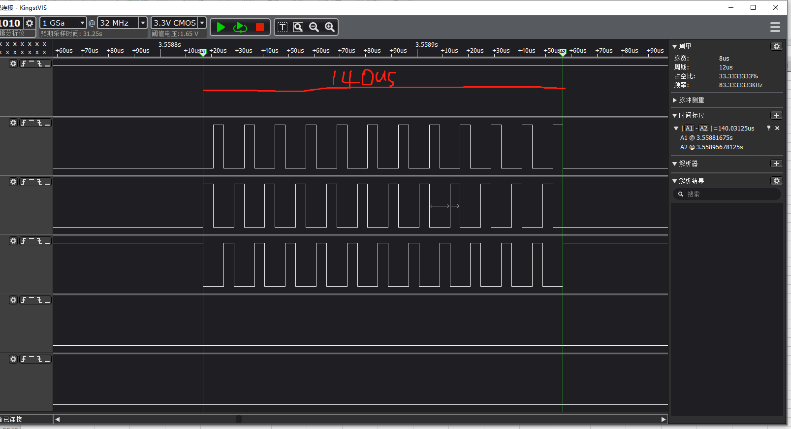

    主要是展示了硬件控制的那几个GPIO,方便用逻辑分析仪监测
  • 关于天线的切换,我用逻辑分析仪抓取了一下引脚,切换只持续了140us,这是正常的吗?
