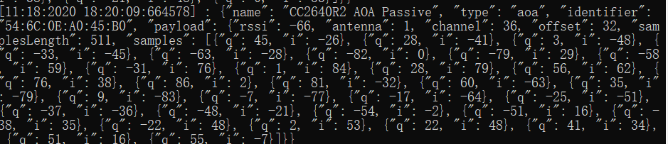

在cc2640的sdk_3_30版本中的AOA功能中,通过脚本采集的i/q数据的参数中的offset代表什么?
采集的数据格式如下:
"name": "CC2640R2 AOA Passive", "type": "aoa", "identifier": "54:6C:0E:A0:45:B0", "payload": {"rssi": -62, "antenna": 1, "channel": 16, "offset": 64, "samplesLength": 511, "samples":
采集的数据格式如下:
看定义:
typedef struct __attribute__((packed))
int8_t rssi; //!< Rssi for this antenna
uint8_t antenna; //!< Antenna array used for this result
uint8_t channel; //!< BLE data channel for this measurement
uint16_t offset; //!< Offset in RAW result (size of samples[])
uint16_t samplesLength; //!< Expected length of entire RAW sample
AoA_IQSample samples[]; //!< The data itself
} rtlsAoaResultRaw_t;
