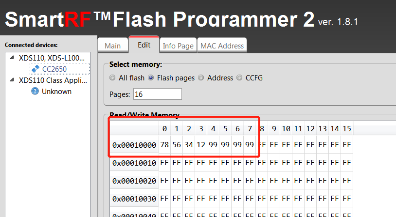

CC2650片上flash读写,为什么有时候能正常读写有时候不行呢?
硬件:CC2650LaunchPad
uint8_t bBuf[4] = {0};
uint_least32_t dstAddr = 0x10000;
uint32_t word = 0x12345678;
FlashSectorErase(16 * BASELOADER_IPAGESIZE);
FlashProgram((uint8_t *) &word, dstAddr, 4);
memcpy(bBuf, (uint8_t *)(dstAddr), 4);
Display_print1(dispHandle, 0, 0, "0x10000 = %x", bBuf[0]);
Display_print1(dispHandle, 0, 0, "0x10001 = %x", bBuf[1]);
Display_print1(dispHandle, 0, 0, "0x10002 = %x", bBuf[2]);
Display_print1(dispHandle, 0, 0, "0x10003 = %x", bBuf[3]);
CPUdelay(800000*50);
dstAddr = 0x10004;
word = 0x99999999;
Display_print1(dispHandle, 0, 0, "0x10004 = %x", bBuf[0]);
Display_print1(dispHandle, 0, 0, "0x10005 = %x", bBuf[1]);
Display_print1(dispHandle, 0, 0, "0x10006 = %x", bBuf[2]);
Display_print1(dispHandle, 0, 0, "0x10007 = %x", bBuf[3]);
下面是打印出来的结果:
// 烧写后第一次单步执行结果: APP init 0x10000 = 78 0x10001 = 56 0x10002 = 34 0x10003 = 12 0x10004 = 99 0x10005 = 99 0x10006 = 99 0x10007 = 99 -------------- // F5直接跑或硬件复位的执行结果: APP init 0x10000 = 78 0x10001 = 56 0x10002 = 34 0x10003 = 12 0x10004 = ff 0x10005 = ff 0x10006 = ff 0x10007 = ff --------------
