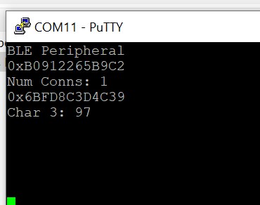

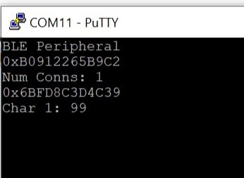

请问如果我想操作CC2640R2F作为从机来发送数据,要调用哪个接口?从机与主机通信的例程要参考哪里?
在如下函数段处理:
static void SimplePeripheral_processCharValueChangeEvt(uint8_t paramID)
uint8_t newValue;
switch(paramID)
case SIMPLEPROFILE_CHAR1:
SimpleProfile_GetParameter(SIMPLEPROFILE_CHAR1, &newValue);
Display_print1(dispHandle, 4, 0, "Char 1: %d", (uint16_t)newValue);
break;
case SIMPLEPROFILE_CHAR3:
SimpleProfile_GetParameter(SIMPLEPROFILE_CHAR3, &newValue);
Display_print1(dispHandle, 4, 0, "Char 3: %d", (uint16_t)newValue);
break;
default:
// should not reach here!
break;
