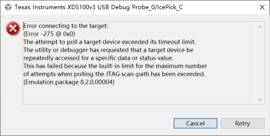

cc1310下载问题
使用XDS100V3下载器,只连接下载器的VREF 、 TMS、 TCK、 GND这四个引脚到板子上,下载时遇到如图属实问题,请问是硬件连接的问题还是软件配置下载参数的问题,谢谢
  • 这是关于这个错误的说明This error happens whenever the JTAG tries to read a target device but it does not respond to the requests after an arbitrary number of retries. This is usually caused by similar conditions as the Lost control of the device execution state and the Security Error. For flash-based microcontrollers, check step 9 of the section Troubleshooting the connect phase above.
    连上RESET后再试试
  • 好的,接上nrest后,调试正常。感谢
