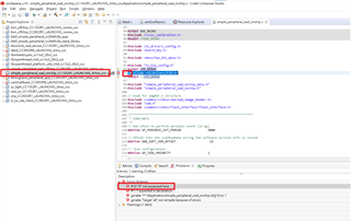

如题,LED_DEBUG宏在哪里定义以及关闭方法?

SDK 5.10的simple_peripheral_oad_onchip的LED_DEBUG宏預設是有被定义,只是目前我也找不到他在那被定义;我會在找找,也開了個帖子在 https://e2e.ti.com/support/wireless-connectivity/bluetooth-group/bluetooth/f/bluetooth-forum/1003067/lp-cc2652rb-where-is-led_debug-defined-in-simple_peripheral_oad_onchip-example-in-sdk-5-10 看看英文E2E BLE forum有什麼回應
