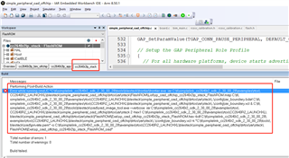

CC2640R2F: 这种编译错误是怎么引起的呢?
Part Number: CC2640R2F
Error while running cmd /C "C:\ti\simplelink_cc2640r2_sdk_2_30_00_28\tools\blestack\frontier\frontier.exe iar C:\ti\simplelink_cc2640r2_sdk_2_30_00_28\examples\rtos\
  • 运行frontier时工具有些错误
