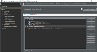

CC2652R: 大家好,ccs升级后项目不能编译了,求教~
Part Number: CC2652R
错误信息如下:

js: "C:/ti/ccs1030/xdctools_3_62_00_08_core/packages/xdc/tools/Cmdr.xs", line 52: Error: xdc.tools.configuro: Error: Can't find the platform package 'ti.platforms.simplelink'. TI platforms are no longer shipped as part of XDCtools (C:\ti\ccs1030\xdctools_3_62_00_08_core). Please ensure you are either using a pre-3.30 version of XDCtools or you have added a product that includes your platform support along the path ';C:\ti\ccs1030\xdctools_3_62_00_08_core/packages'. Check that this path names a directory containing the necessary platform support and that the platform name is properly spelled.

希望有人能指出问题~
