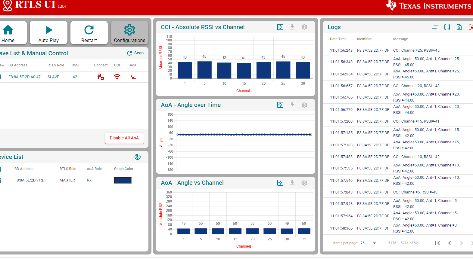

LAUNCHXL-CC26X2R1: 用一块master+slave组合时,计算AOA角度,可视化程序无法计算角度
Part Number: LAUNCHXL-CC26X2R1

Initialization started
Log file of current session at : E:\TI\simplelink_cc13x2_26x2_sdk_5_10_00_48\tools\ble5stack\rtls_agent\rtls_ui\logs\09_27_2021_10_41_46_log.txt
- WebSocket Proxy Client Connected
Initialization done
127.0.0.1 - - [27/Sep/2021 10:41:52] "POST /rtls-ui/api/initialize HTTP/1.1" 200 -
- WebSocket Proxy Server Started
127.0.0.1 - - [27/Sep/2021 10:41:52] "GET /rtls-ui/api/initialize HTTP/1.1" 200 -
Finalize started
Receive command STOP
错误: 没有找到进程 "raw_calculator*"。
成功: 已终止进程 "websocket_proxy.exe",其 PID 为 29812。
CCI Stopped
AOA Stopped
Finalize done
127.0.0.1 - - [27/Sep/2021 10:41:59] "DELETE /rtls-ui/api/initialize HTTP/1.1" 200 -
Log file of current session at : E:\TI\simplelink_cc13x2_26x2_sdk_5_10_00_48\tools\ble5stack\rtls_agent\rtls_ui\logs\09_27_2021_10_41_59_log.txt
Initialization done
127.0.0.1 - - [27/Sep/2021 10:42:05] "POST /rtls-ui/api/initialize HTTP/1.1" 200 -
127.0.0.1 - - [27/Sep/2021 10:42:06] "GET /rtls-ui/api/initialize HTTP/1.1" 200 -
Scan process started
Scan process done
127.0.0.1 - - [27/Sep/2021 10:42:16] "POST /rtls-ui/api/scan HTTP/1.1" 200 -
Connection process started
Connection Success
127.0.0.1 - - [27/Sep/2021 10:42:18] "POST /rtls-ui/api/connection HTTP/1.1" 200 -
Scan process done
127.0.0.1 - - [27/Sep/2021 10:43:05] "POST /rtls-ui/api/scan HTTP/1.1" 200 -
Finalize started
成功: 已终止进程 "websocket_proxy.exe",其 PID 为 12228。
CCI Stopped
AOA Stopped
Master Disconnected
Finalize done
127.0.0.1 - - [27/Sep/2021 10:44:56] "DELETE /rtls-ui/api/initialize HTTP/1.1" 200 -
Log file of current session at : E:\TI\simplelink_cc13x2_26x2_sdk_5_10_00_48\tools\ble5stack\rtls_agent\rtls_ui\logs\09_27_2021_10_44_56_log.txt
Initialization done
127.0.0.1 - - [27/Sep/2021 10:45:01] "POST /rtls-ui/api/initialize HTTP/1.1" 200 -
127.0.0.1 - - [27/Sep/2021 10:45:02] "GET /rtls-ui/api/initialize HTTP/1.1" 200 -
Finalize started
成功: 已终止进程 "websocket_proxy.exe",其 PID 为 16312。
CCI Stopped
AOA Stopped
Finalize done
127.0.0.1 - - [27/Sep/2021 10:45:05] "DELETE /rtls-ui/api/initialize HTTP/1.1" 200 -
Log file of current session at : E:\TI\simplelink_cc13x2_26x2_sdk_5_10_00_48\tools\ble5stack\rtls_agent\rtls_ui\logs\09_27_2021_10_45_05_log.txt
Initialization done
127.0.0.1 - - [27/Sep/2021 10:45:12] "POST /rtls-ui/api/initialize HTTP/1.1" 200 -
127.0.0.1 - - [27/Sep/2021 10:45:12] "GET /rtls-ui/api/initialize HTTP/1.1" 200 -
Scan process done
127.0.0.1 - - [27/Sep/2021 10:45:22] "POST /rtls-ui/api/scan HTTP/1.1" 200 -
Connection Success
127.0.0.1 - - [27/Sep/2021 10:45:24] "POST /rtls-ui/api/connection HTTP/1.1" 200 -
CCI Started
127.0.0.1 - - [27/Sep/2021 10:45:56] "POST /rtls-ui/api/cci HTTP/1.1" 200 -
AOA Paramas Set
AOA Started
127.0.0.1 - - [27/Sep/2021 10:46:01] "POST /rtls-ui/api/aoa HTTP/1.1" 200 -
CCI Stopped
127.0.0.1 - - [27/Sep/2021 10:48:01] "PUT /rtls-ui/api/cci HTTP/1.1" 200 -
AOA Stopped
127.0.0.1 - - [27/Sep/2021 10:48:04] "PUT /rtls-ui/api/aoa HTTP/1.1" 200 -
CCI Started
127.0.0.1 - - [27/Sep/2021 10:48:08] "POST /rtls-ui/api/cci HTTP/1.1" 200 -
AOA Paramas Set
AOA Started
127.0.0.1 - - [27/Sep/2021 10:48:13] "POST /rtls-ui/api/aoa HTTP/1.1" 200 -
