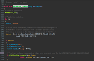

LAUNCHXL-CC26X2R1开发板在未连接的状态下,rtls_slave应该是广播的状态,具体广播的代码在那呢?

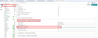

MAX_NUM_BLE_CONNS可以在syscfg裡修改
CC2652R1F最多可连接多少个终端设备取決於RAM大小,你可以參考 https://e2e.ti.com/support/wireless-connectivity/bluetooth-group/bluetooth/f/bluetooth-forum/975352/cc2642r-what-s-the-maximum-connection-slavers-can-be-supported/3603896?tisearch=e2e-sitesearch&keymatch=MAX_NUM_BLE_CONNS#3603896
