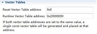

I have build a project base on the example:rfPacketTx_cc26x2R1_LAUCHXL.(SimpleLink CC13x2/CC26x2 SDK 3_20_00_68:),
It works perfect until I change the FLASH_BASE from 0x0 to 0x2000 and errors come out like below!!
I have searched the TI E2E design support forums and found that a same issue was post before。
https://e2e.ti.com/support/wireless-connectivity/bluetooth-group/bluetooth/f/bluetooth-forum/842588/ccs-launchxl-cc26x2r1-customer-bootloader-for-cc26x2/3128011?tisearch=e2e-sitesearch&keymatch=%25252520user%2525253A291339#3128011
and he sovled the issue by modify the vector table address.
But I can't find where it is。
Does anyone know it?  Can anyone help me?I have been confused of this for several days!
