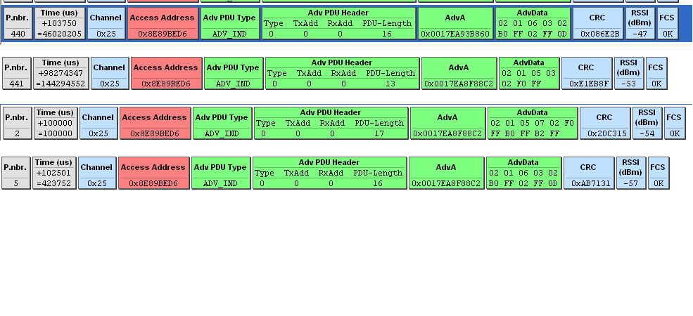

  • 应该不是那样的吧,在SimpleBLEPeripheral工程的simpleBLEPeripheral.c中有这样的定义:
    static uint8 advertData[] =
      // Flags; this sets the device to use limited discoverable
      // mode (advertises for 30 seconds at a time) instead of general
      // discoverable mode (advertises indefinitely)
      0x02,   // length of this data
      GAP_ADTYPE_FLAGS,
      DEFAULT_DISCOVERABLE_MODE | GAP_ADTYPE_FLAGS_BREDR_NOT_SUPPORTED,
      // service UUID, to notify central devices what services are included
      // in this peripheral
      0x07,   // length of this data
      GAP_ADTYPE_16BIT_MORE,      // some of the UUID's, but not all
      LO_UINT16( SIMPLEPROFILE_SERV_UUID ),
      HI_UINT16( SIMPLEPROFILE_SERV_UUID ),
      LO_UINT16( TEST_SERVICE_UUID ),
      HI_UINT16( TEST_SERVICE_UUID ),
      LO_UINT16( ENABLE_SERVICE_UUID ),
      HI_UINT16( ENABLE_SERVICE_UUID ),
    这个就是定义CC2540外设的广播数据吧,里面就定义了有UUID,而且我用Packet Sniffer也抓到了广播出来的数据确实是有UUID的,UUID应该不是iphone自己生成的。
    附件中有我抓到的广播数据,AdvData中就有UUID
  • 这个UUID只是服务的UUID, 并不是IOS为区别设备产生的UUID.
    这个不会影响IOS去区分设备. 最终IOS设备还是靠mac地址来区分外设的.
