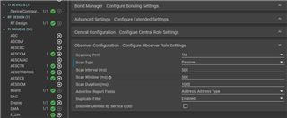

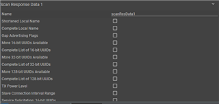

有兩張LAUNCHXL-CC1352R1,  一張用於simple_peripheral,   另一張用於simple_central,  SDK:simplelink_cc13xx_cc26xx_sdk_6_10_00_29.
syscfg 中相關設定為
advParams1:
Legacy Event Properties Option: Connectable directed
Peer Address Type: Public Or Public ID
Peer Address: 10:33:2B:B0:6F:80 (此為simple_central的Dev Addr: 0x806FB02B3310)
Filter Policy: Process requests from all devices
advData1:
Public Target Address:  V
Num Of Public Addresses:  1
Public Address 0:  10:33:2B:B0:6F:80
用simple_central 無法找到simple_peripheral的directed advertisement
請問除了simple_peripheral的syscfg外,需要做其他設置嗎?
