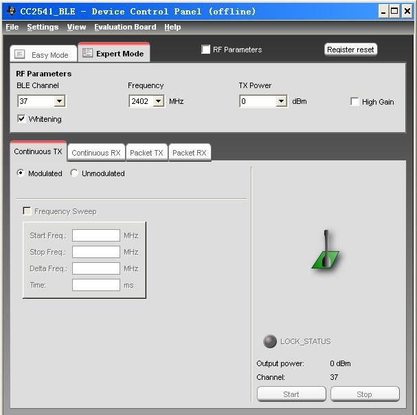

HI,各位好,我的问题如题,还请多多支持,谢谢!
SMART RF studio工具可以让BLE持续发功率,如附件 ble RF.JPG所示,在BLE-CC254x-1.4.0代码包里是否有源码?
有个Vendor Specific HCI Command "HCI_VS_DRPb_Tester_Con_TX" 来设置连续发送模式。你可以在HCI_Tester 里面找到。
请参考:
http://processors.wiki.ti.com/index.php/LPRF_BLE_HCITester
