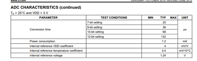

Part Number: CC2540
CC2540 ADC设置12bit采集, AVDD5=3.3V, 测试电压1.5V, 采集的ADC只有920左右.
为什么在12bit下ADC的范围只有2048? 不是4096?
您好,
You should not get more than 2047 as the result will always be in 2's complement where the MSb will be used to determine the sign (-/+). For single ended 12-bit you should expect results between 0 and 2047 (b0-b0000 0111 1111 1111).
