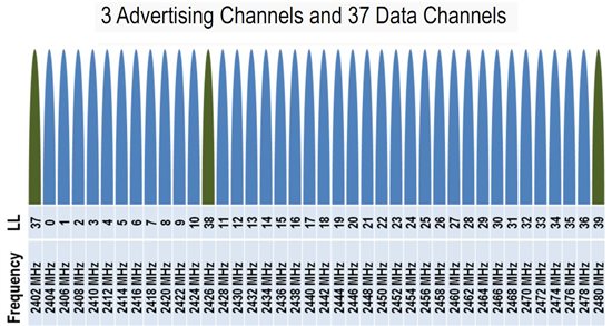

  • BLE有类似的定义,但是名称不叫AFH.
    4.5.8 Data Channel Index Selection 4.5.8.1 Channel Classification The master’s Link Layer shall classify data channels into used channels (used for the connection) and unused channels (not used for the connection). This is called the channel map. The minimum number of used channels shall be 2. The Host may provide channel classification information to the Link Layer. The Link Layer may use the information provided by the Host. The slave shall receive the channel map from the master in the CONNECT_REQ PDU. If the master changes the channel map it shall notify the slave as specified in Section 5.1.2.

    BLE 不叫AFH,叫做channel map, 是以固定的序列跳,不是随机,然后一段时间改变一次。
    既然你了解AFH,你可以看一下蓝牙的spec,看一下BLE 的channel map 机制,对你来说肯定不难理解。

    2、找到自行编写的CC2540_RF测试程序的问题所在,HCI_EXT_ModemTestTxCmd函数的参数信道是函数自行定义的而并不是实际的物理信道。
    1)该函数使用 RF Channel = (BLE Frequency – 2402) / 2 所以2402MHz对应的是0信道(逻辑信道),实际2402MHz对应的是37信道(物理信道)。
    2)修改参数后测试与SmartRF Studio测试的现象一致,说明程序结构没有问题。
