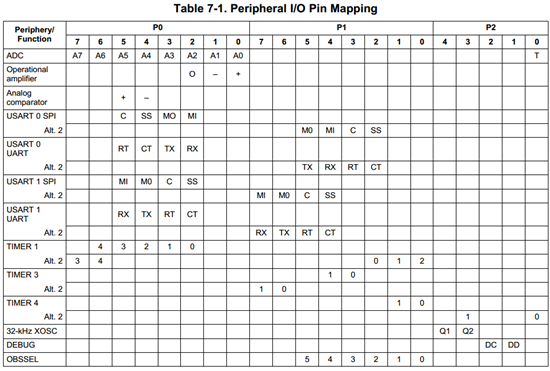

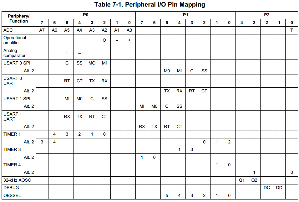

cc2541定时器和IO配置冲突的问题
我的目的是每秒输出20个周期方波,然后休眠
我在学习swrc257.zip中的例子
发现IO管脚和TIMER冲突
在t3_modulo.c中
#pragma vector = T3_VECTOR
__interrupt void t3_isr(void)
    // Clears the module interrupt flag.
    T3OVFIF = 0;
    // Toggles LED1 on SmartRF05EB or CC2544Dongle.
    P0_4 ^= 1;  // Toggle SRF05EB LED1.
    /* Changes the Timer compare value to change the LED blinking interval.
     * The value increases and decreases linearly between 0xFF and 0x02.
     * Writing to the compare register T3CC0 does not take effect on the
     * output compare value until the counter value  is 0x00. (Writing to
     * the compare register T3CC1 takes effect immediately.)
    static int8 sign = -1;
    if (T3CC0 == 0xFF || T3CC0 == 0x02)
        sign *= -1;
    T3CC0 += sign;
    // Clears the CPU interrupt flag.
    T3IF = 0;
* @fn          main
* @brief       LED1 and Timer 3 are both initialized. The rest of the program
*              is executed by interrupts from Timer 3.
* @param       void
* @return      0
int main(void)
     * Setup clock & tick frequency
     * Configures the Timer tick speed setting, resulting in a Timer tick
     * frequency of 250 kHz.
    CLKCONCMD = (CLKCONCMD & ~CLKCON_TICKSPD) | CLKCON_TICKSPD_250K;
     * Setup I/O
     * Select P1_0 direction to output
    // LED1 as GPIO.
    P0SEL &= ~BIT4;
    // Set LED1 as output.
    P0DIR |= BIT4;
     * Setup interrupt
     * Enables global interrupts (IEN0.EA = 1) and interrupts from Timer 3
     * (IEN1.T3IE = 1).
    EA = 1;
    T3IE = 1;
     * Timer 3 setup
     * Timer 3 channel 0 compare value. Initiates the Timer terminal count value
     * to 0x02. This value is changed at each Timer compare match interrupt.
    T3CC0 = 0x02;
    /* Timer 3 channel 0 (T3CCTL0) configuration:
     * - Channel 0 interrupt enabled.
     * - Compare mode.
    T3CCTL0 = T3CCTLn_IM | T3CCTLn_MODE;
    /* Timer 3 control (T3CTL) configuration:
     * - Prescaler divider value: 64.
     * - Modulo mode.
     * The Timer is also cleared and started.
    T3CTL = T3CTL_DIV_64 | T3CTL_MODE_MODULO | T3CTL_CLR | T3CTL_START;
    // Infinite loop.
    while (1);
这样程序会跑飞掉
红色部分换成
P0_5^= 1;
P0SEL &= ~BIT5;
 P0DIR |= BIT5;
就是正常的
我想知道是怎么回事,找了半天也没有相关的文档说明。请指教,谢谢
