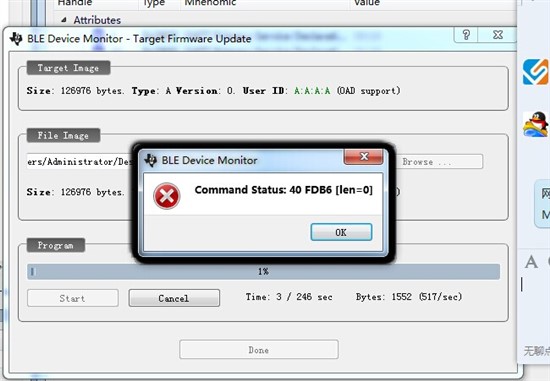

用的是什么版本的协议栈?先参考下帖子 http://e2e.ti.com/support/wireless_connectivity/f/538/t/327903.aspx 希望对您有帮助
已解决!
"Wait 5-10 seconds after connect before you go into the OAD item on the file menu"
It works for me.
