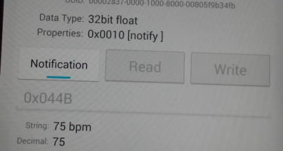

HeartRate 例子问题
static uint8 heartRateMeasProps = GATT_PROP_NOTIFY;
static uint8 heartRateMeas = 0;
static gattCharCfg_t heartRateMeasClientCharCfg[GATT_MAX_NUM_CONN];
把其改为下面的代码:
// Heart Rate Measurement Characteristic
// Note characteristic value is not stored here
static uint8 heartRateMeasProps = GATT_PROP_NOTIFY|GATT_PROP_READ|GATT_PROP_WRITE;
怎么还是只有notify,其他的都没变?read,write还是灰色的,不可用。
