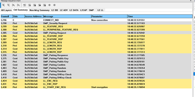

1.  CC2340 to RSL10:After a short connection it stays stuck at "Pairing status: started" and then terminates the connection.(Both basic ble SDK and my program are same result.)
The packet capture result as follows:

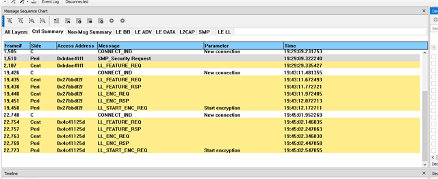

2, CC2340 as central and another CC2340 as peripheral can succeed:

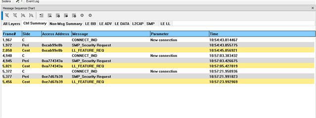

3, But CC2642 as central can connect and pair :

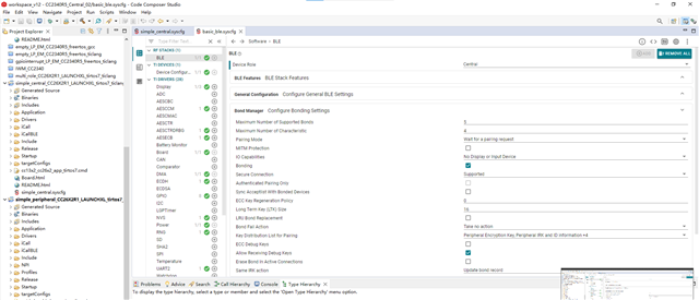

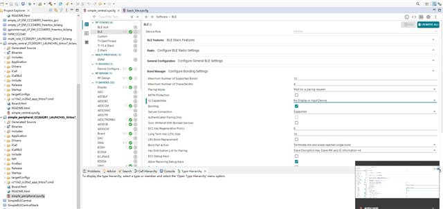

Relevant syscfg as foolows:
CC2642(SDK simple central)
CC2340(SDK basic ble)
