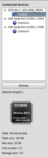

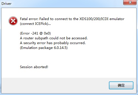

SmartRF06 Evalution Board(CC2650),List of connected devices:已经找到仿真器XDS100v3、Device CC2650(图1),但无法进入Device Control Panel(图2)
有没有遇到过类似情况的,麻烦分享下解决方法,谢谢!

Programmer软件也是一样,能获取Device信息,图1。
但是无法进行后续操作,如Erase,promgram,verify等,执行Erase之后就会有如下Status信息:
>Initiate access to target: XDS-06EB_PREPA.
>Failed to read target memory.
>Error while reading memory range. Address 0x40091090.
>Start flash erase ...
>Unable to halt target CPU
>Reset target ...
>Reset of target successfull.
