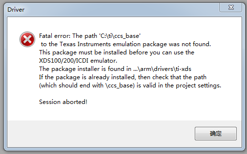

用IAR下载程序到SmartRF06 CC2650EM板时出现以下Error:
Fatal error: The path 'C:\ti\ccs_base' to the Texas Instruments emulation package was not found. This package must be installed before you can use the XDS100/200/ICDI emulator. The package installer is found in ...\arm\drivers\ti-xds If the package is already installed, then check that the
IAR的版本最好是7.40.3以上,在IAR安装目录下,C:\Program Files (x86)\IAR Systems\Embedded Workbench 7.40_3\arm\drivers\ti-xds目录下有个ti_emupack_setup.exe,你安装了看看
