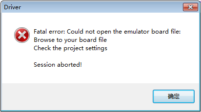

fatal error:Could not open the emulator board file:Browse to your board file check the project settings session aborted

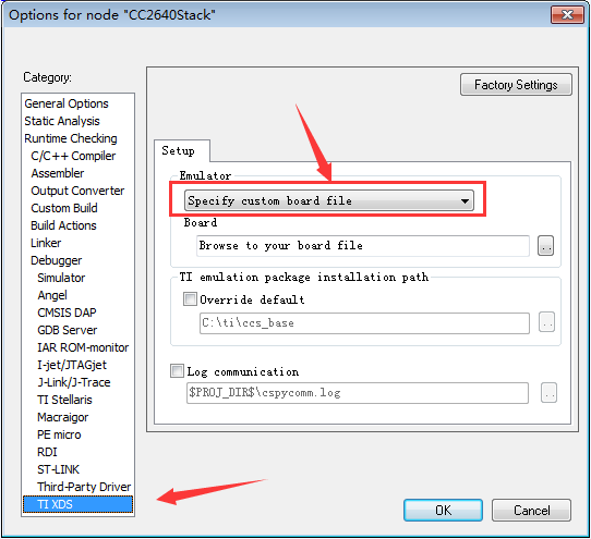

CC26410调试下载出现该错误,如图,经发现是由于XDS没有选择正确的版本

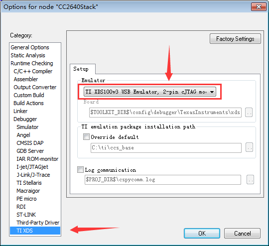

如图改正就好了:
