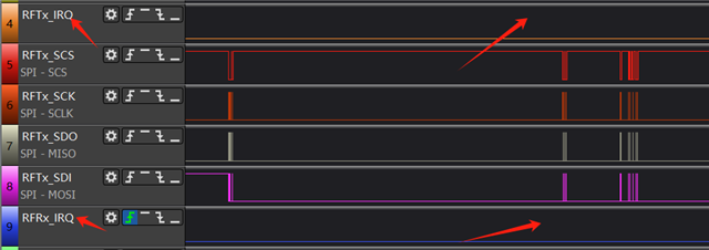

就是我每1秒发送0x01  0x7A  0x00 0x00后,正常情况下是280us左右GD0会变高电平132us,然后拉低
  这个就不正常了,TX发送完数据后,GD0没有高电平脉冲输出
这个是正常的信号

I am not sure I understand. What camera are you talking about?
If I am going to be able to help you I need to know all the communication that are sent over SPI.
That means the complete radio configuration (all register settings), and also what 0x01 0x7A 0X00 0X00 (payload, FIFO writes, register writes ??????)
